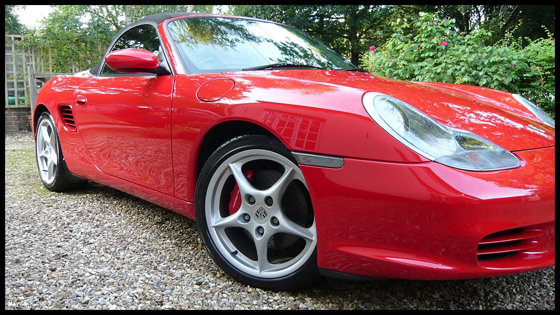

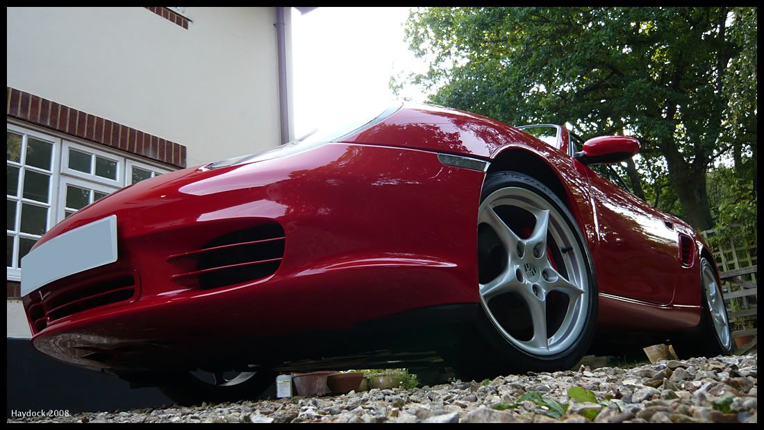

ahaydock Posted February 20, 2009 Report Share Posted February 20, 2009 (edited) I polished a Guards Red Boxter and it had a clearcoat: The paint was quite hard, and if working by hand I would suggest you wash, clay, polish with AG SRP working in areas of about a ft sq, work it in well then remove with a MF. Then add 2x layers of EGP on the top (leaving 24hrs between). SRP/EGP works well on alloys to. More pics of the Boxter are here: Guards Red Porsche Boxter S Full G220 Correction and Supernatural V2 - Detailing World Edited February 20, 2009 by ahaydock Link to comment Share on other sites More sharing options...
JonC Posted February 21, 2009 Report Share Posted February 21, 2009 Wow, there is some depth of shine on that boxster. EGP is pretty awesome stuff. Link to comment Share on other sites More sharing options...
steelwind101 Posted February 22, 2009 Report Share Posted February 22, 2009 Nice work Ahaydock! As per Ahaydocks advice if you want to use the products you have then thats the way to go. You can use the UDS as a good base for many other products, it cleans the paintwork and fills in minor swirls. As you have red, i would probably say pick up a nice Nuba wax that will give you a deeper wetter finish and bring out the red more. Just as an idea of some suggestions: Victoria Wax Concours (red) about £17, really good wax and lasts about 10 weeks before you need to reapply. You can apply over your current application. DoDo Supernatural, a really good wax! £15 for a sample, see on ebay. The little pot will give you about 6-8 applications, each application should last for around 10-12 weeks. Nattys Original, cheap, wet and easy to use £12 for an 8oz tub! Will last around 6-8 weeks super wet, super easy. Clearkote Moose Wax, the king of wet and depth. £18 for a 16OZ container. Doesnt bead or sheet very well from the start, durability is about 10 weeks. Complimented on your colour by using Yellow Moose before hand. As you can see for less then £20 you can use your current UDS and get on a really nice product to enhance the looks over what you would get with the EGP or Aqua Wax. In the winter (a long way of i hope!) you can return to the UDS>EGP with AW maintance! No doubt others will chip in a few other waxes of similar calibre for the price. If you look at post made yesterday by Tarmac Terrorist he is using Supernatural wax on a red car. Geoff Link to comment Share on other sites More sharing options...

ahaydock Posted February 27, 2009 Report Share Posted February 27, 2009 Thanks guy for the comments on the Boxter. Just to confirm it was polished via machine using Menzerna Polishes, followed by CG EZ Creme and topped of with 2x layer of Dodo Supernatural V2 Link to comment Share on other sites More sharing options...
