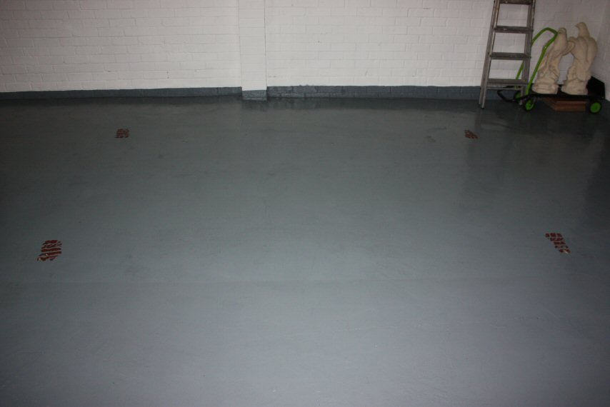

Phantom Posted November 2, 2009 Report Share Posted November 2, 2009 Hi Guys, quick question for you....has anyone tried painting a garage floor with International's garage floor paint ? After finally managing to clear out my double garage after moving here three years ago, I thought it was time to spruce up the garage. I spent over a month painting and then waiting for two coats of this garage floor paint to harden before driving the car inside the garage. I followed all of International's recommendations on prepping the floor before painting. Got home yesterday after a lengthy drive from Cornwall, reversed out this morning only to find some of the paint had peeled off and was stuck to my tyres. Turns out that there is a known problem with this paint in that it is not very resistant to heat from the car tyres. Yes I could put rubber mats down where the tyres would sit on the garage floor or I could leave the car outside for an hour until the tyres have cooled down, but it sort of defeats the object. Just wondering if there is a heat resistant clear sealant that I could paint over the garage floor ?. Having spent a £100 on the paint so far I don't really want to spend too much on this. Needless to say I have emailed the paint manufacturer to see what they say but it looks like a common problem. Anyone else experienced this and if so how did you sort out the problem, Cheers Link to comment Share on other sites More sharing options...
Milo Posted November 2, 2009 Report Share Posted November 2, 2009 Hi Phantom. A couple of things - International (Akzo Nobel) make one of the best (if not the best) garage floor paint on the market as well as producing most of the own brand ones out there. I've got the same problem as you. The surface prep has to be absolutely spot on or else you'll get problems and when the car sits in the same spot, sometimes wet, you're always going to risk it peeling. Once that happens, you're goosed. The only way to repair it is to strip everything back to bare concrete and start again. I'm sick of it so after the New Year, I'm changing my approach - http://www.tyresmoke.net/forum/general-cars/122075-garage-floor-tiles.html Link to comment Share on other sites More sharing options...
