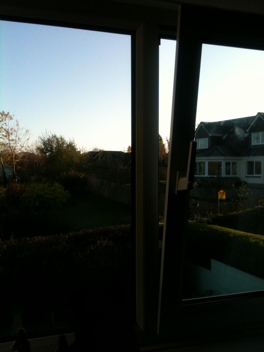

Maxyboy Posted November 6, 2011 Author Report Share Posted November 6, 2011 They aren't a solution to the problem either, what type of windows do you have?If they are the UPVC type, they will often have a vent position, where they can be locked in the almost shut position, so they allow ventilation but are still secured. Just home now, they are upvc yes, but they don't really have a proper vent position. They have 3 positions, shut/top open and fully open. I will try and put it in an in between position tonight and see how I get on. [ATTACH]44971[/ATTACH] The photo shows the top open position which is just too much. If tonight works I'll just have to try an remember and close them all properly before leaving the house. Ps the windows were all fitted before I bought the house. Link to comment Share on other sites More sharing options...
Calm Chris Posted November 6, 2011 Report Share Posted November 6, 2011 What was the update on the air bricks, have they been obscured by pebble dash, or might they be closed via the vent 'slid' function on the inside covers? Link to comment Share on other sites More sharing options...
