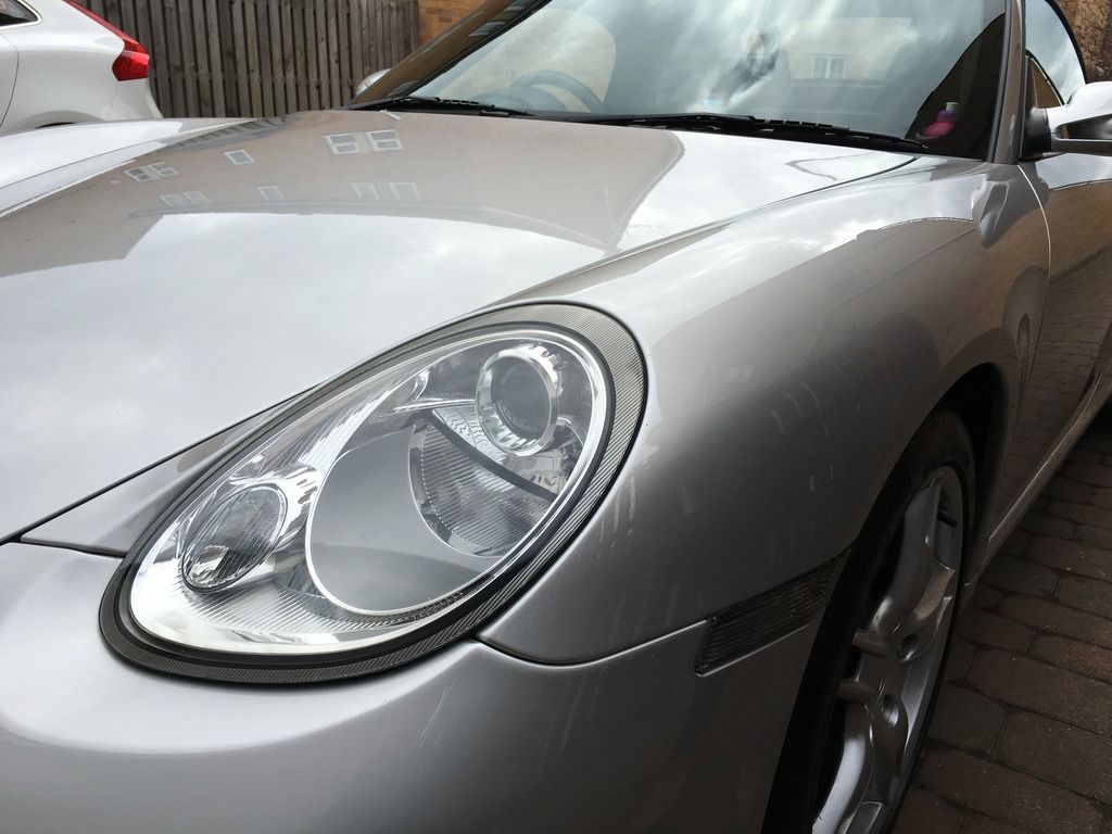

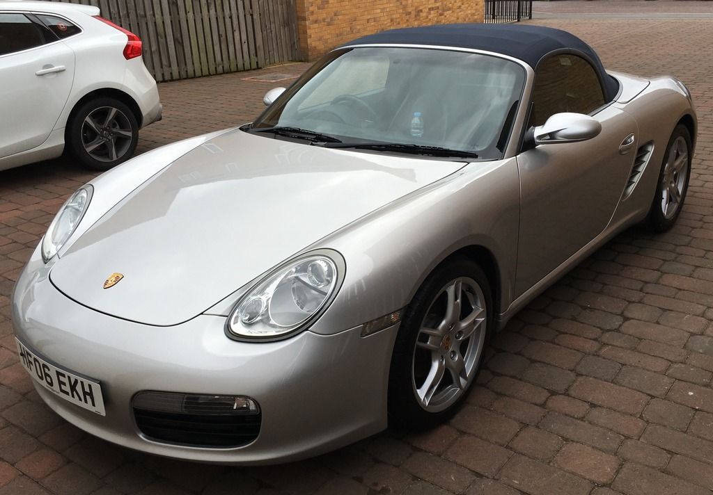

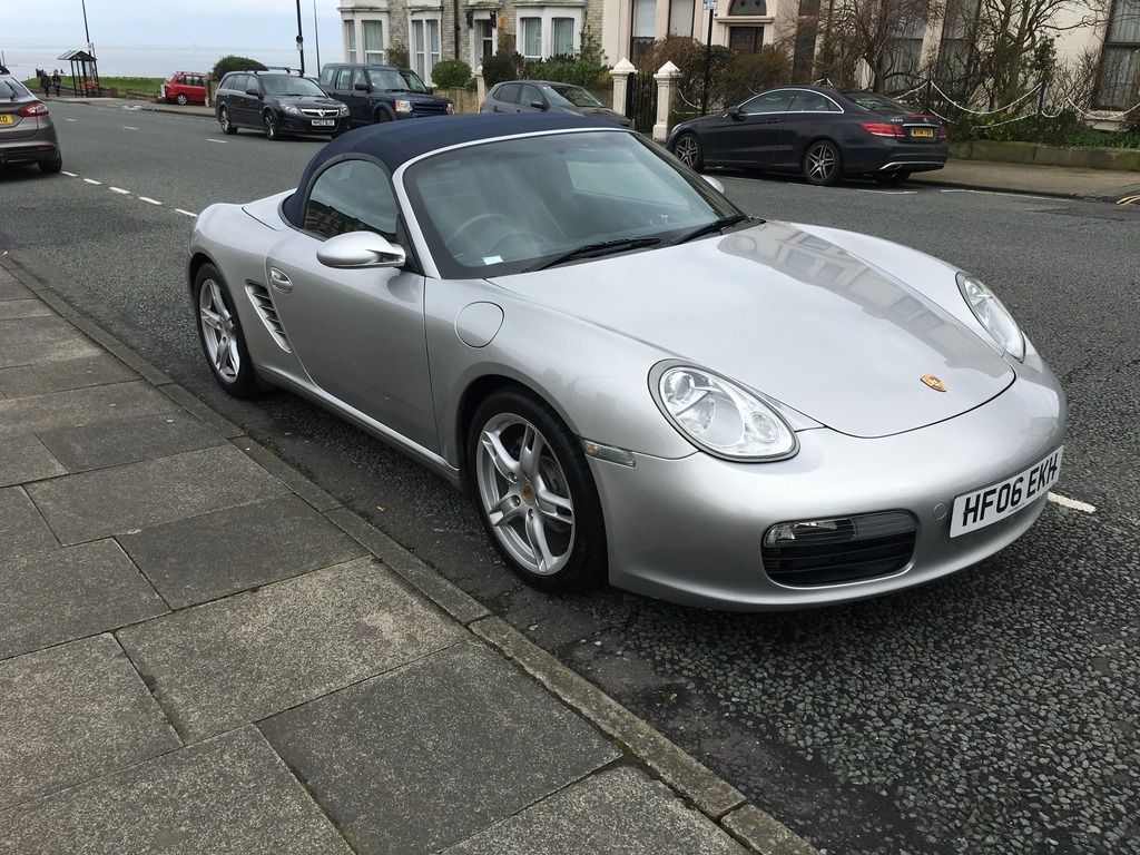

eldavo69 Posted April 11, 2016 Author Report Share Posted April 11, 2016 After about 10 hours of work I've finished the paintwork over the weekend, it is completely transformed and has a real glossy shine to it that will have been missing for the past few years: Got the roof down in the sun and went for fish and chips at the coast: 1 Link to comment Share on other sites More sharing options...
Ian_C Posted April 11, 2016 Report Share Posted April 11, 2016 Looks great! Time to update your sig! 1 Link to comment Share on other sites More sharing options...

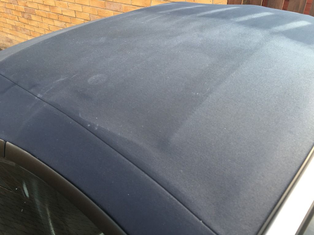

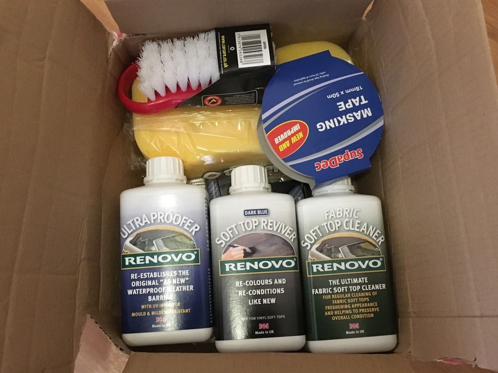

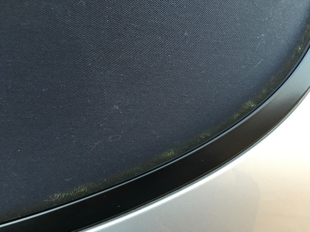

eldavo69 Posted April 11, 2016 Author Report Share Posted April 11, 2016 The Renovo kit I ordered for the roof turned up too. This contains a cleaning solution, roof dye and then a reproofing sealant with all the necessary application gubbins. If I don't need the dye I'd rather not use it but I'll be able to make a better decision once the roof is properly clean. Here's the full kit; And the roof that was noted on the PPI as "minging": Link to comment Share on other sites More sharing options...

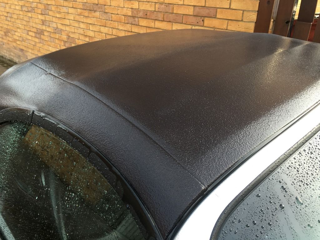

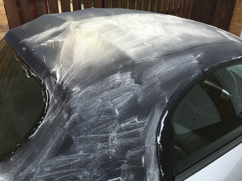

eldavo69 Posted April 11, 2016 Author Report Share Posted April 11, 2016 First step was to lightly wet the roof and you can see it just absorbed all the water: Then brush on the cleaner, leave to dwell for 10 mins before wetting and agitating. Lots of whitey/brown foam with the odd green bit: Then several damn good rinses before drying the car off ready to go back in the garage to be left overnight with the dehumidifier running: It already looks much better so fingers crossed I can skip the dye! Link to comment Share on other sites More sharing options...

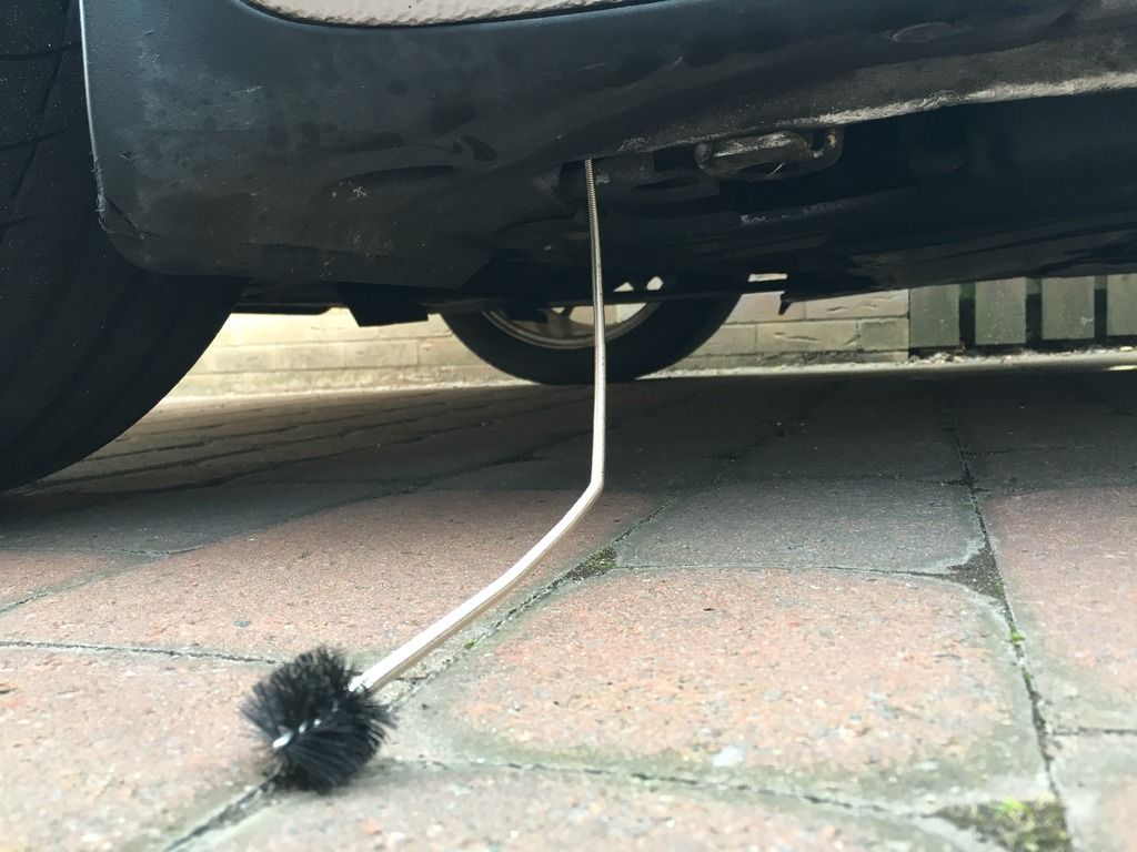

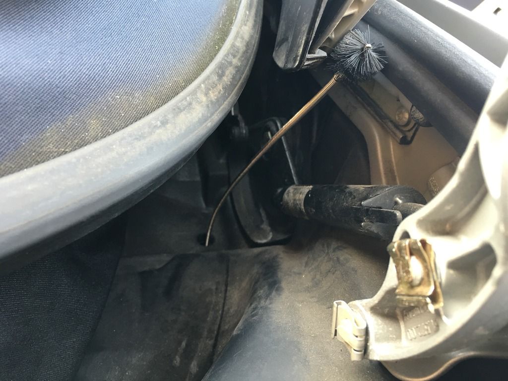

eldavo69 Posted April 11, 2016 Author Report Share Posted April 11, 2016 Before starting on the roof I whipped out my trusty trombone cleaner: And got to work cleaning out all the drain holes, you can see just how manky the bottom of the roof was: And out the other end (I really must dress that plastic arch guard): 1 Link to comment Share on other sites More sharing options...
