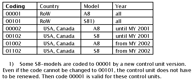

Sven Posted July 19, 2004 Report Share Posted July 19, 2004 Somewhat puzzling... Looking at Paul's recoding page I see there are not only codes specified by engine (I gather from the screenshot), but also they are different from the EU repair manual. And yes, they display the US/Canada codes as well. So how come? What's with the difference, and where does Bentley get these codes from? (I thought AOA). <ul type="square"> [*] Bentley codes [*] EU codes Interestingly, it says: <ul type="square"> Other codings are not permissible [*] Once the coding operation has been completed the fault memory in the control unit is automatically erased. [*] If an invalid code number is entered the control unit retains the old coding. So how does that add up? On a sidenote is mentioned the A8 reaches top speed in 4th gear, and 5 is basically set as an 'overdrive' whereas the S8 reaches top speed in 5th gear. Any comments guys? Last but not least, I'd be really interested to see the Bentley S8 gearbox codes, so if someone could post a screenshot of those, I'd be very grateful! Link to comment Share on other sites More sharing options...

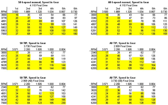

PaulW Posted August 2, 2004 Report Share Posted August 2, 2004 Sven- Been busy....looked in the Bently, but only saw the stuff for the U.S. bound A8....but here's something that Randy Young has done: He did this looking at a S8 (with a higher redline than the A8 that's why the speed is slightly higher in gear) and A8 with different final drives/combinations. The US A8 has a final drive of 2.909 for fuel economy, it revs very low. I believe all A8/S8's in Europe came with the 3.730 final drive.....which is what the S8 came to the states with. Then we were talking about the six speed manual that came in Europe and what speeds it would have.....Randy made this chart.... Does this help? I could look again in the Bently if it doesn't....but I will have to find where exactly it has this info.... pw Link to comment Share on other sites More sharing options...
Sven Posted August 2, 2004 Author Report Share Posted August 2, 2004 Cheers Paul, According to the manual the EU S8 has 4,111 and (4D) A8 4.2 3,700. That should go for the tip as well, I checked the S8 with my own final drive, not 100% certain there were no other options for the 4.2, but IIRC not (for EU). I suppose the reason why the recoding options - which is what I'm interested in - are partly different because the EU manual doesn't list the 'DSP off' codes (see screenshot above, in my 1st post). Maybe not a desired code from a factory point of view? I did a bit of a search on AW, and it appears there were some people with 'issues' using the 11 code? Anyways, I'm interested to see if Bentley has any 'DSP off' codes for the S8. My oil change hasn't been done yet BTW, as they discovered there was a seal missing from the ordered parts... (glad they waited, and didn't put the old one back in) So they just did the main service. Hopefully soon... Link to comment Share on other sites More sharing options...
