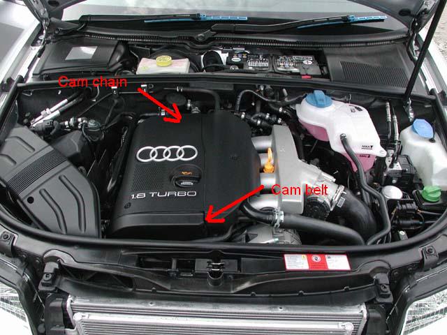

Mollox Posted May 8, 2006 Report Share Posted May 8, 2006 Hey Mulk, Can you explain the difference between the Cam belt (which has its own cambelt tensioner?) and the cam chain tensioner on the 1.8T please? One's at the front and the other's on the back of the engine isn't it? Link to comment Share on other sites More sharing options...
mulkbear Posted May 8, 2006 Report Share Posted May 8, 2006 The cam belt is the main belt on a 1.8T engine it has it's own tensioner and the belt plus tensioner is mounted at the front of the engine. It controls the timing of the main cam shaft and the crank shaft plus it runs the water pump. The timing chain on the 1.8t engine controls the timing of the main cam shaft and the second cam shaft. The cam chain is tensioned by a oil pressure controlled tensioner. The cam chain and tensioner are mounted under the cam cover at the rear of the engine. Link to comment Share on other sites More sharing options...
