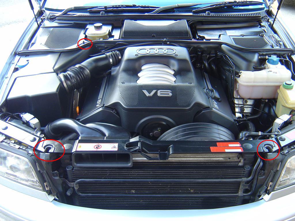

Ska Posted May 9, 2006 Report Share Posted May 9, 2006 The sensors you guys refer to are pin swicthes IMO (look near the brake fluid reservoir, remember when closing the bonet there are two catches at each end. The boot has two pin switches on the actual err boot lid, may be a broken connection or dry joint etc. Its all about taking them out and completing the circuit. Do you have the beep feature on when locking it? because from what I've seen on my car if you leave a door/bonnet/boot ajar then the doors do lock but there is no beep to signify the alarm is set. If you do then when you lock and if you have a faulty pin switch then it wont beep when locked. Link to comment Share on other sites More sharing options...

SneakyMcC Posted May 11, 2006 Report Share Posted May 11, 2006 The horn is here. The CD changer sits below.... Link to comment Share on other sites More sharing options...
