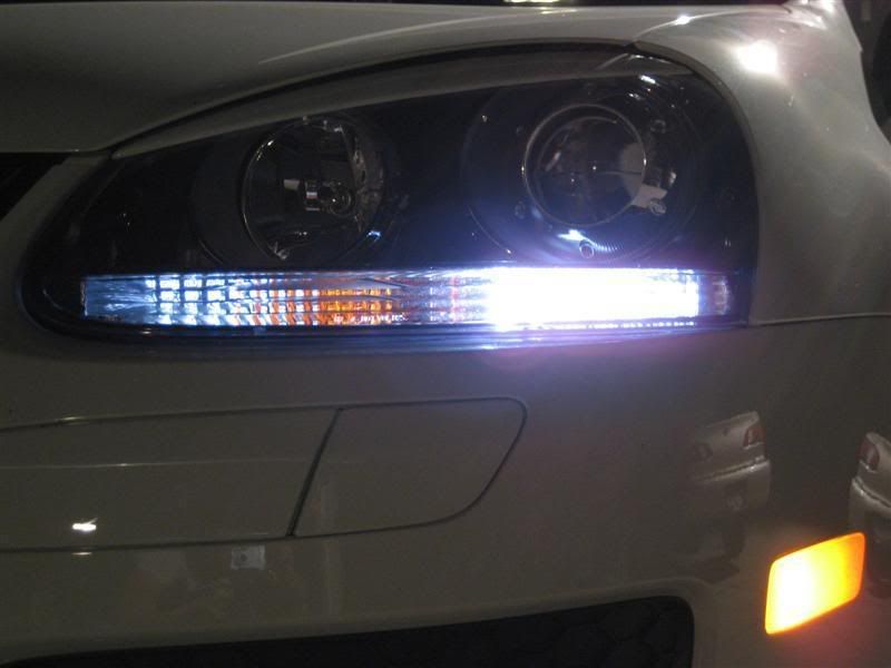

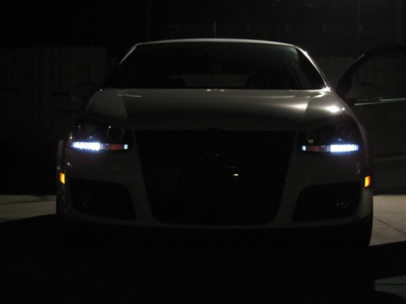

VR32 Posted August 13, 2007 Report Share Posted August 13, 2007 I've found the best bulbs to use which match the Xenon closest are these Polarg bulbs, can be found on ebay. Have lasted over a year so far with no issues. Pics show the effect they give although not quite that blue in real life. Link to comment Share on other sites More sharing options...
Mark230175 Posted August 13, 2007 Author Report Share Posted August 13, 2007 Thanks for that info Dogbucket VR32 those bulbs look pretty cool, nice and bright, i presume they are similar to the PIAA extreme white ones, which ive also been looking at. Link to comment Share on other sites More sharing options...
