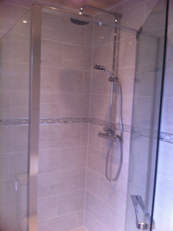

Calm Chris Posted August 31, 2016 Report Share Posted August 31, 2016 There's 193 dual outlet flush / concealed mounted mixers here -> http://www.tapwarehouse.com/category/concealed-thermostatic-shower-valves/?term=&page=1&sort=&NumberOfOutlets=2+Outlets have you thought about having a chat with the hospital plumbing teams? I'd imagine they have several dozens of wet rooms and they will be well versed with offsetting the mixer, and having static shower head and tap / hand shower facilities. You will need to clarify the water pressure for the mixer, hot water via a high flow combi, stord hot water or a pressure based system? Link to comment Share on other sites More sharing options...

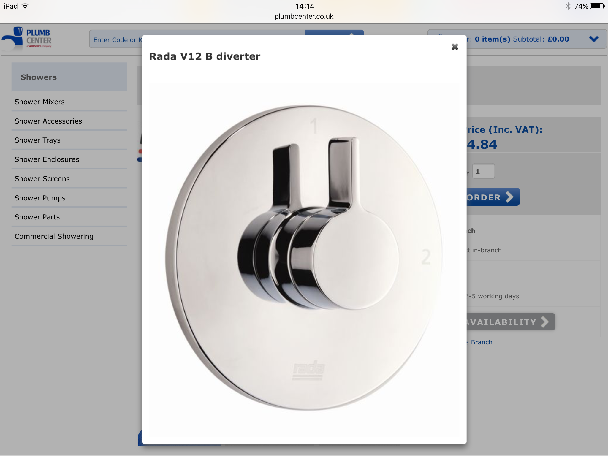

Daz Posted September 3, 2016 Report Share Posted September 3, 2016 Usually you turn the on-off either forwards or backwards to select fixed or flexible. Or you buy one like this which has a separate control valve just above it. 1 Link to comment Share on other sites More sharing options...
Waylander Posted September 3, 2016 Author Report Share Posted September 3, 2016 Ash okay same as on the shower plus taps. I couldn't see it/ work out the back or front thing from the pix. I think one luke yours above with a separate valve is the way to go. Even better if as Chris says we can mount it by the seat so in the pic above on the left wall if shower is "front" Link to comment Share on other sites More sharing options...
Daz Posted September 3, 2016 Report Share Posted September 3, 2016 It maybe better to have a concealed valve. That way you can have the overhead and flexible where ever you want. You can also put the valve in the best place too. I can show you some various pics when I get home. 1 Link to comment Share on other sites More sharing options...

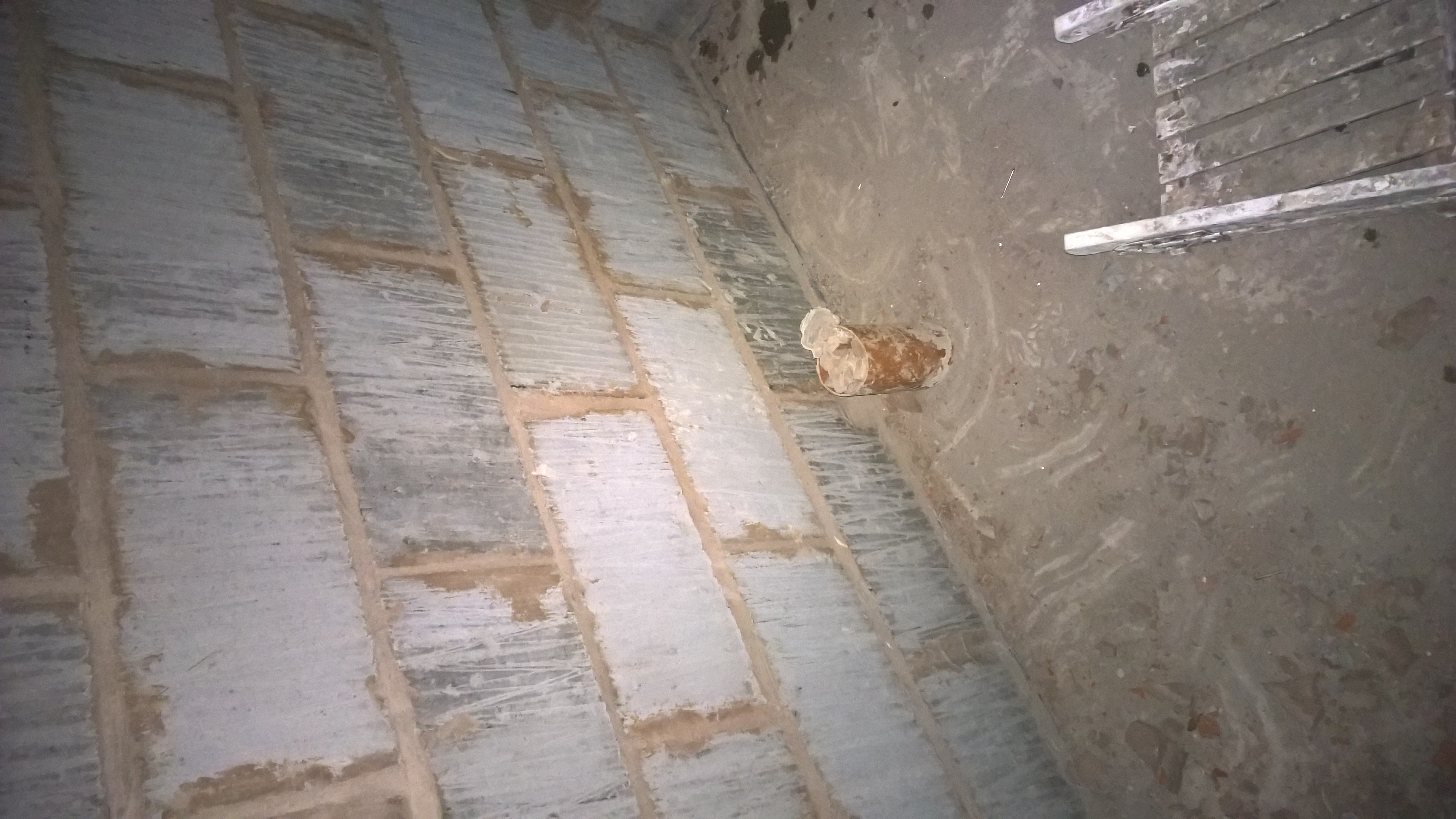

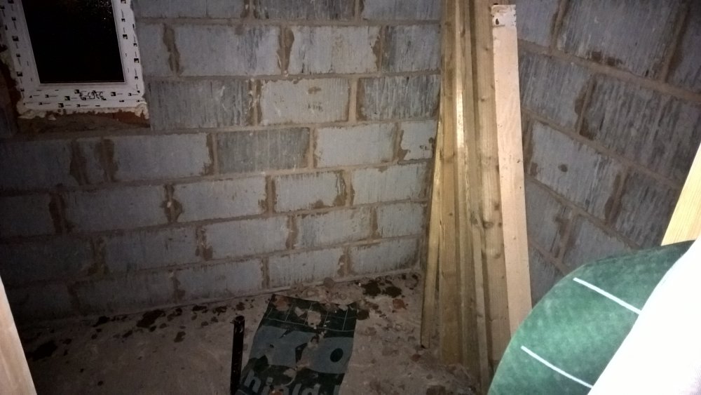

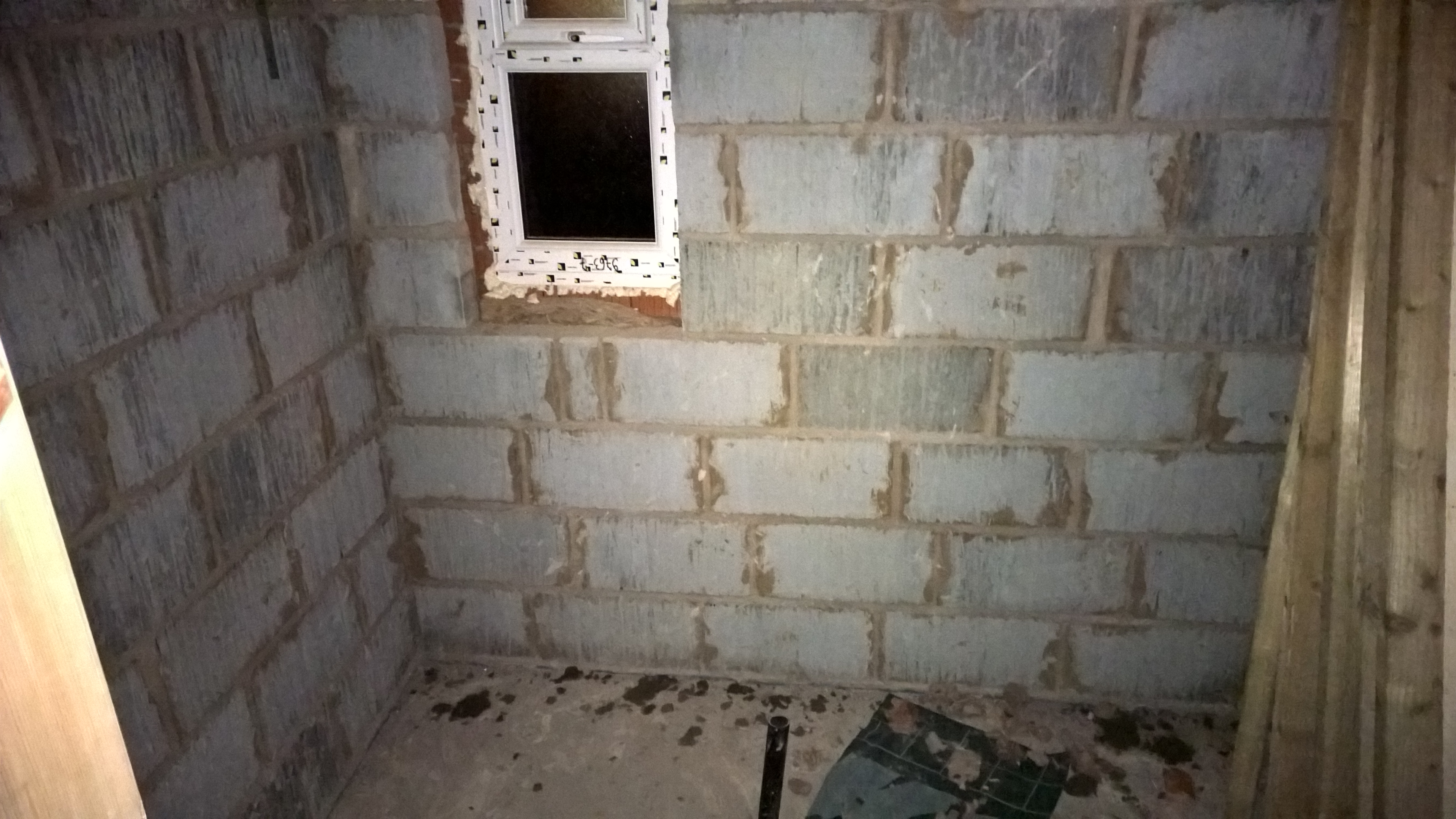

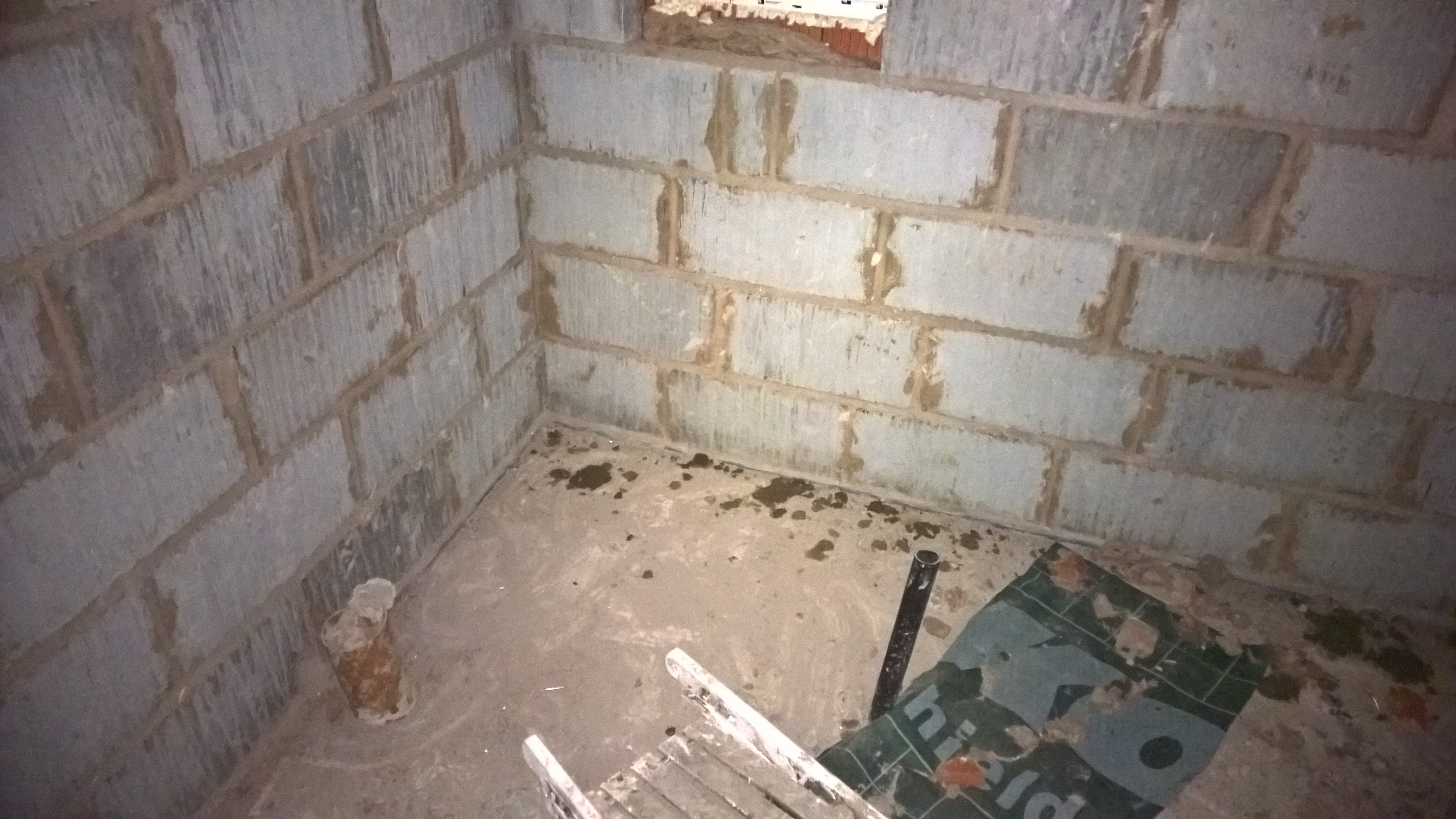

Waylander Posted January 4, 2017 Author Report Share Posted January 4, 2017 okay so i have a week off this week. I'm already half way through it. And the entire rest of the time will be taken up finalising the contents of the wet room. the tiles are sorted the flooring is sorted. That leaves sink, toilet. shower stuff as well of course the folding shower seat and grab handles etc. Shower seat I've seen a few (will run my finalised choice by you gents imminently). my major preoccupation is the toilet. I'll post a couple pics below. As you can are the soil pipe is concreted in vertically on one side. It is very close to the wall. A mate suggested as I'm after the polyflor I should go for a wall-hung toilet so there is no screw going into the floor as a potential source of leak-damage etc. The floor installer though says it isn't as much of a big deal as long as the toilet contact with the floor is sealed with silicon not screws. what do you chaps advise? As you can see it's a small room and i am worried the frame for the concealed cistern might take up more space, but everything I read online says an advantage of wall hung toilets is space saving?? Link to comment Share on other sites More sharing options...
Waylander Posted January 4, 2017 Author Report Share Posted January 4, 2017 It looks a mess because the roof is in the process of being dismantled and rebuilt as per new planning permission that came through just before Xmas.... sink will go just to right of the window and shower on the facing wall on the right side. Link to comment Share on other sites More sharing options...
