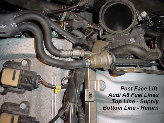

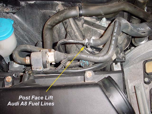

PaulW Posted August 2, 2004 Report Share Posted August 2, 2004 [ QUOTE ] It did start when the cambelt was changed your right but I'm guessing there is no way of proving it, they'll just say it's down to age deteriation. She's in for her M.O.T. tomorrow, so I might mention it again then. [/ QUOTE ] If you have a pre facelift 32 valve motor....and it started after the timing belt change....it's because they were leaning on the fuel lines when they put the cam locks in on the right hand head....it's easy to lean on them! Link to comment Share on other sites More sharing options...
Sven Posted August 2, 2004 Report Share Posted August 2, 2004 I understand this issue doesn't occur on the later models? Ben, I'd stay with Sneaky on this. I imagine these aren't cheap to replace... Link to comment Share on other sites More sharing options...
PaulW Posted August 2, 2004 Report Share Posted August 2, 2004 They have different connectors....gee....wonder why? I just so happen to have some archieved for your viewing pleasure.....just uploaded them! First the old style that leak: Now here's the post face lift lines....you can see they just have clamps on them, but the high pressure supply line is kinda like the old style.....but have never heard of one leaking yet.... This one is just under the plastic piece just aft of the airbox....all the connectors are like these. Link to comment Share on other sites More sharing options...

SneakyMcC Posted August 2, 2004 Author Report Share Posted August 2, 2004 Thanks PW. As always, staggering quality input. Would you kindly tell me what this item is? (bottom rh corner, that does the clicking) Link to comment Share on other sites More sharing options...
Sven Posted August 2, 2004 Report Share Posted August 2, 2004 Cheers Paul, that put's my mind at ease a bit... I read Ben's post too quickly... he said "fancy having a one peice pipe that runs front to back on the car", ad I read it as " I fancy having a one piece pipe that runs front to back on the car". One letter, big difference... Still, try to get it from them, you can only win. If not you can still repair it... Link to comment Share on other sites More sharing options...
PaulW Posted August 2, 2004 Report Share Posted August 2, 2004 If that is the third line that is routed with the fuel lines, which it looks like it is.... Then it's part of the evaporative controls. It's a hose used to capture fuel or oil vapor (don't know what).....then it brings it to the back side of the car where the tank is.....and I think it purges it through a charchol canister....the electrical device probably works off a differential pressure in the tank, etc. I've read about it before....but right now I'm just taking a stab at it....but it is for emmissions and vapor recovery. pw Link to comment Share on other sites More sharing options...

SneakyMcC Posted August 2, 2004 Author Report Share Posted August 2, 2004 Thanks PW, I've mailed this pic to the Audi centre, dont suppose the service adviser would know, but their tech's should. This thing clicks so loudly sometimes. There is no way Audi would have such an item be so noisey? Sven did suggest summit to do with the charchol canister. Link to comment Share on other sites More sharing options...

Sven Posted August 2, 2004 Report Share Posted August 2, 2004 Duh, that's the charcoal filter soilenoid valve N80. I even put up two diagrams for you... You're telling me now you didn't even download them? Link to comment Share on other sites More sharing options...

Sven Posted August 3, 2004 Report Share Posted August 3, 2004 I think that's standard generic dealer speak. Imho it's only Quattro models where they completely remove the rear axle *if* they need to take out the fuel tank. At FWD cars they need to take off the springs tho, so it needs to be disassembled up to a point. It's no surprise the fuel line replacement is expensive really. I'd go for the PW fix if they don't do warranty/courtesy. The siren you could do yourself I suppose... For pads & discs you could go aftermarket... (ask Botang). What's with the wiring? Link to comment Share on other sites More sharing options...
Sven Posted August 3, 2004 Report Share Posted August 3, 2004 [ QUOTE ] I think I will live with the leak. [/ QUOTE ] Don't, it's dangerous... use the PW fix! Link to comment Share on other sites More sharing options...
