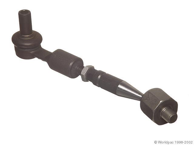

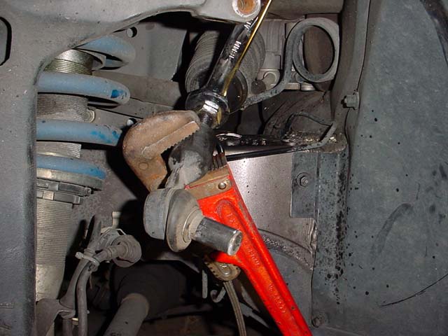

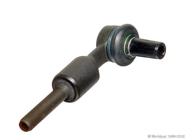

PaulW Posted September 3, 2004 Report Share Posted September 3, 2004 Oh, that's too easy. The A8's have problems with the tie rod ends going bad. When they go bad, the car "trams" it feels as if you are in a rut going down the highway when you're really not. You need to replace the tie rod ends, sometimes they can freeze up, and they are a real PITA to get out, and in one case I needed to replace my whole tie rod which includes an inner and outer assembly because I damaged the inner when I tried to force the outer off for two hours! Here's the outer assembly that needs to be replaced, do both sides: Here's the whole assembly, it screws into the steering rack, has another joint on the inboard side: And here's Paul creating another "Waterlooism" (that's my last name) by hacking up the boot and damaging the inner assembly..... I've replaced my outer tie rod ends twice already, once at about 60K miles and again at about 100K miles, but I do track my car and run over aligators on the run off area! Link to comment Share on other sites More sharing options...
