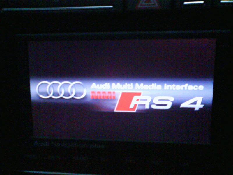

PetrolDave Posted December 24, 2006 Author Report Share Posted December 24, 2006 Picture of RS4 startup screen Quote Link to comment Share on other sites More sharing options...
