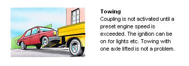

Paul Posted February 22, 2008 Report Share Posted February 22, 2008 Official response from Haldex site is.... ok with one axel lifted... (screen shot from their site) However, Audi Assist do not tow, or use Spectical lift on Quattro fitted cars. They ALWAYS specify a flatbed. I personally would not accept anything but a flatbed/ or trailer for that reason. Link to comment Share on other sites More sharing options...
