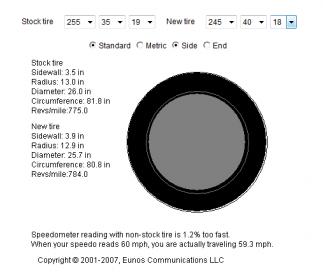

Andy_Bangle Posted December 2, 2010 Report Share Posted December 2, 2010 (edited) Still sounds like Audi UK BS. Check on the tyre pressure chart for your model and see what wheel size options there are. The only thing that stops you downsizing the wheels is the brake clearance. As for "grounding issues" again, pure BS. If you downgrade from 255/35 R19 to 245/40R18 then there is only a .3 of an inch difference in diameter. Plus you'll save 80 quid a corner, they only reason Audi says you can have it is because they don't stock it! Edited December 2, 2010 by Andy_Bangle Link to comment Share on other sites More sharing options...

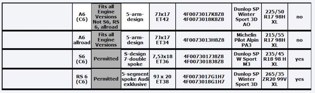

Andy_Bangle Posted December 17, 2010 Report Share Posted December 17, 2010 (edited) Dan, attached are the p/n's and wheel sizes for the A6 winter tyre/wheels program. This guy ships to the UK for 69 euros: Audi A6 4F S-Line 17 Zoll Winterreifen Alu Winterräder bei eBay.de: Kompletträder (endet 08.01.11 23:55:31 MEZ) This one look good too: http://translate.google.com/translate?langpair=sv|en&u=http%3A%2F%2Fcgi.ebay.de%2FAlu-Winterrader-Audi-A6-Typ-4F-%2F260709303259%3Fpt%3DAuto_Komplettr%C3%A4der%26hash%3Ditem3cb37c43db (google translate is your friend ) BTW, none are personal recommendations - just suggestions. Edited December 17, 2010 by Andy_Bangle Link to comment Share on other sites More sharing options...

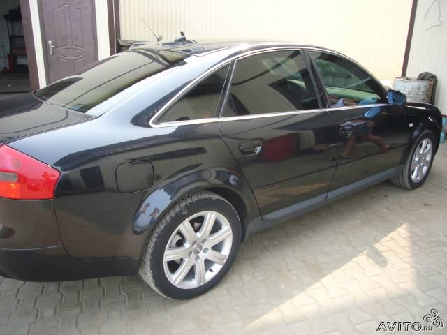

Nelson_R32 Posted December 29, 2010 Report Share Posted December 29, 2010 Audi's wheels are alloy I've got some 16 inch Audi Winter wheels with bridgestone winter tyres going on the quattro tomorrow Not the most attractive wheels in the world but they'll do the job, should look like something below. Just an update for everyone, I sold my R32 3 months ago and i'm now on the lookout for a decent Corrado, which will bel be going into storage for winter, so they won't be needed for that Link to comment Share on other sites More sharing options...
